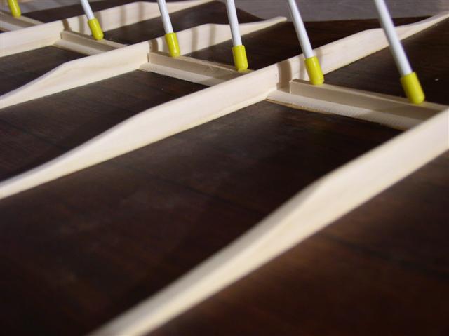

How about making braces of Port Orford cedar? Seems like this would be one of the best. If it was good enough for sir Thomas Lipton or a Japanese temple maker, why not for a guitar builder? It's got an amazing texture and is my favorite smelling wood so far. It is also stronger than spruce from what I hear.
Since we're on the subject of braces I have another question, the answer to which I have gratefully received a few clues from reading this thread already. I've noticed how some builders shape their braces with radical rounded little mountains on them, which seems to be a more exagerated form of the scalloping seen on old Martins. Is this arrived at through using a stiffness gauge? The strength of height must be involved, but what else goes into the shaping of such braces? An example that comes to mind is on the top for the 13th fret guitar project I saw a picture of on line. nickton38994.8142361111
